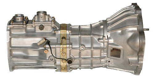

Transmission Specification
G52 & G54 Transmissions
The G52 and G54 both used a forward shifting Type 2-B transfer case. The over all length of the transmission is 25 3/8" long. The length from the bell housing to the center of the Transmission shifter is 18 7/8". The length from the bell housing to the center of the transfer case shifter is 23 1/4"
  • Years used: 1984-1988
  • Uses Type 2-B forward shifting t/case
Right Side View

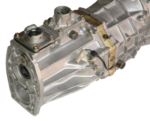

Front View
Rear & Shifter View
