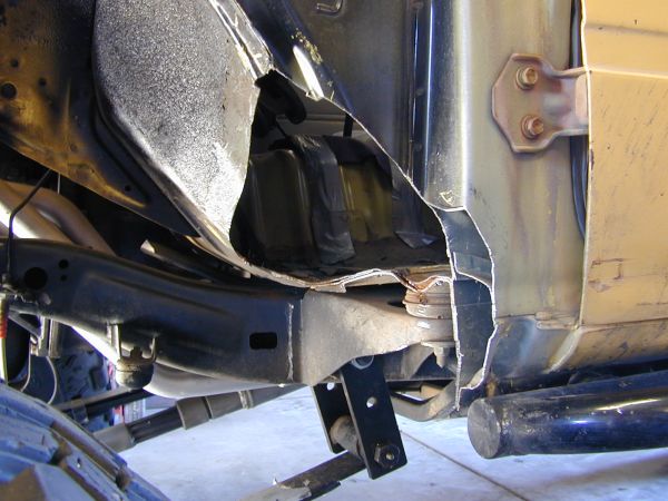

   The first step is to take off the fenders and drive up an RTI ramp. Then using a pen to mark the firewall any place that looked like it would be within an inch of contacting the tire. The wheels were turned full left and right while on the ramp. The marked area was then cut out and removed. This included more than three inches of sheet metal and a good part of the firewall behind the tires. After cutting the truck was put back on the ramp to verify the clearance and see if anything else needed to be cut.

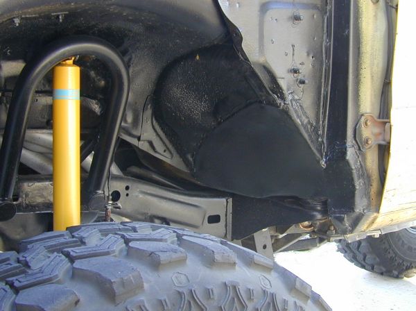

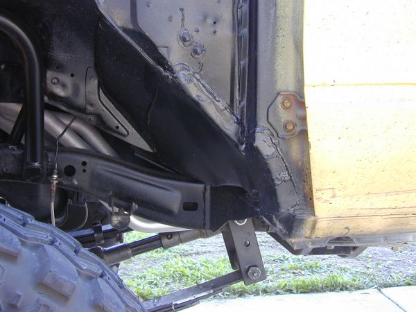

   Next 18 gauge steel was cut to shape on a bandsaw and bent to form around the hole. The plate is actually larger than the hole size to allow some overlap. Small additional plates were cut out to cover parts of the hole missed by the large plate. After a little hammering the plate is then tacked in place. One more time up the ramp to insure proper tire clearance. Next the plate is finish welded with one inch weld stitches around the hole on both sides.
   After welding the seam was sealed with professional seam sealer obtained from a local body shop. While it would be possible to use silicone glue for this step the seam sealer is a two part epoxy style glue that has incredible strength and will last a long time. After waiting a day for the epoxy to dry the entire wheel well was covered with rubberized undercoating to prevent rust and provide additional waterproofing.
